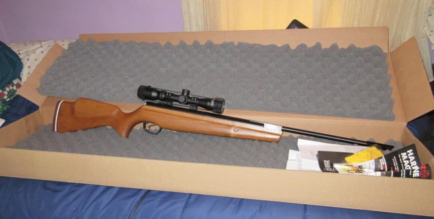

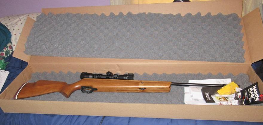

Took me 2 weeks to get the rifle and a couple of phone calls to even get a shipping confirmation from AOA which appears to be pretty standard for them although they'll take your payment inside 5 minutes for anything you order and the scope I got added to the deal they mounted for me, also something i won't recommend letting them do as mine came off the rifle in the first 20 shots because it wasn't torqued down properly. Part my my fault for not checking but I also shouldn't have had to if the person mounting it knew what they were doing.

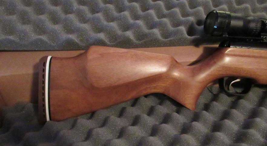

The walnut stock is spotless with no blemishes or marks and it gives the rifle a nice solid fee and considering it's made by Hatsan, it looks way better than the stock on my Mod 95. No marks or light spots in the bluing or the ported muzzle break. It comes without sights so you definitely need a scope and I got the Hawke Vantage 2-7x32 AO IR scope deal they offered with the riflel. I already own one and they're real nice scopes so it was a no brainer to get a normally $130 scope for $30.
I didn't adjust the trigger yet but it comes with the gold Quattro trigger and SAS and I also got the bonus of a break in the weather so I got some shooting in. There's a bit of metal rubbing when cocking but I oiled the barrel forks and that stopped in about 20 shots or so. Cocking is a smooth pull all the way through and about 30-35 pounds cocking effort so not very hard at all. It's a springer and there was some twang and buzz when I first started but that's also starting to fade and the recoil is actually less than I thought it would be and after AoA shooting it and me putting over a 100 pellets through it, it shoots very nicely.

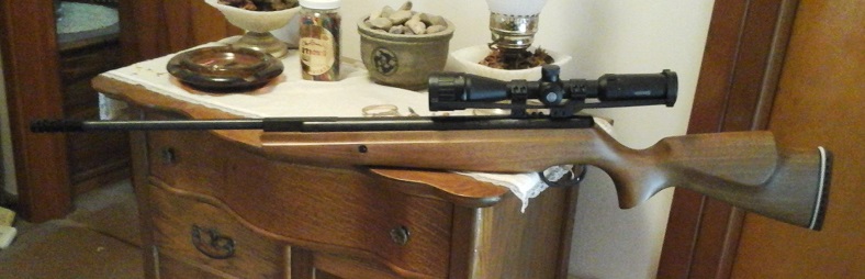

If you're in the market for a .22 springer with nice power and seriously accurate, the Tomahawk is a great choice provided you can find one . AOA no longer carries the .22 and the only place I've found left so far that does is Pyramyd Air. The last picture is the final setup with the Hawke Vantage 3-9x40.
